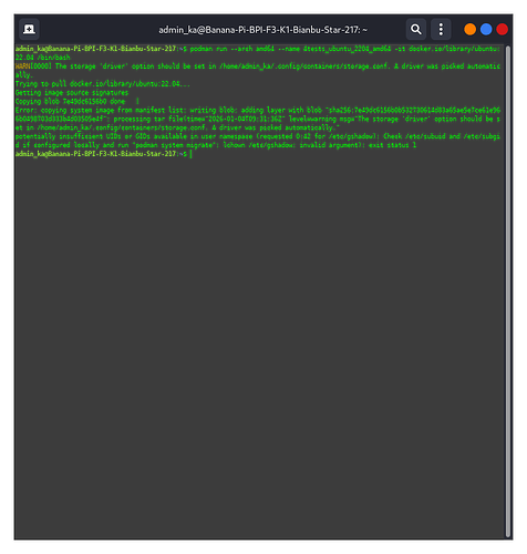

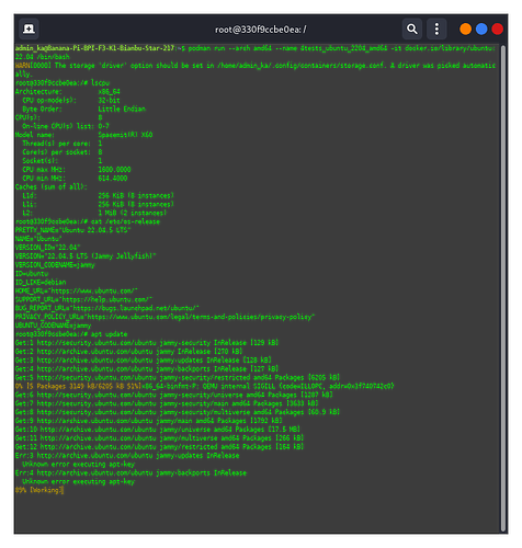

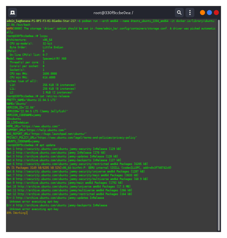

I haven’t yet created any specific containers for other processor architectures on BS-2.1.7 and B-2.2.1; I just decided to check how standard containers created from official Ubuntu 24.04 images would work.
Summary
But an attempt to create a similar container from an Ubuntu 22.04 image fails with the following error:
Summary
I also tried fetching the container image by
podman run --arch amd64 --name test-qemu -it docker.io/library/ubuntu:24.04 /bin/bash
and running the following commands, but still encountered no errors.

I figured out what was going on. When I was compiling the Linux kernel, I decided to rename the user to the same name as on the forum, but forgot to change the group. I fixed it. Now:
Summary

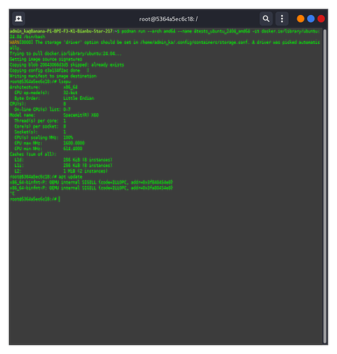

I used the same board and switched the firmware to Bianbu 2.2rc3 (previously I was using Bianbu 3.0), and successfully reproduced the issue. I will continue investigating the problem on Bianbu 2.2rc3. Could you please try upgrading your firmware to Bianbu 3.0 or a newer version to test?
root@1eaed8173998:/# apt update
x86_64-binfmt-P: QEMU internal SIGILL {code=ILLOPC, addr=0x3f7c042100}
x86_64-binfmt-P: QEMU internal SIGILL {code=ILLOPC, addr=0x3f80135f40}

It could be due to differences in Podman versions. Running the command outside the container does not cause any issues, but it results in an “illegal instruction” error inside the container.
qemu-x86_64 -L xxx/rootfs xxx/rootfs/usr/bin/dpkg -i xxxx.deb

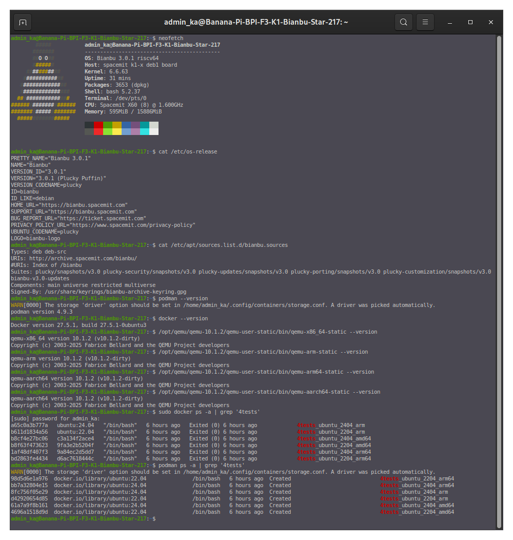

So, I tested the following OS versions:
  1. Bianbu v2.2rc2, updated to 2.2rc3
  2. Bianbu LXQT v2.3.0
  3. Bianbu v3.0
  4. Bianbu v3.0.1
With the following results, in OS order:
Versions 1 and 2 show the same containerization errors in Podman and Docker, similar to Bianbu Star 2.1.7 and Bianbu 2.2.1
3 and 4 allow you to run containers for any architecture simultaneously. It’s a shame it’s Ubuntu 25.10 and not LTS 24.04.3

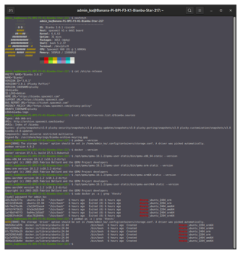

So, I finally decided to upgrade the system from Bianbu Star 2.1.7 to Bianbu 3.0.1.
A lot of things were removed during the upgrade; some new things were installed, but others weren’t.
After the upgrade, I decided to check containerization again.
I think the screenshot is clear enough!
Containers in Podman and Docker were created and updated without errors!
However, Podman still wasn’t updated; it remained the same as Bianbu Star 2.1.7.
Docker was updated.
Qemu remained the same, compiled manually. However, everything worked fine. So the issue is most likely with system libraries.
