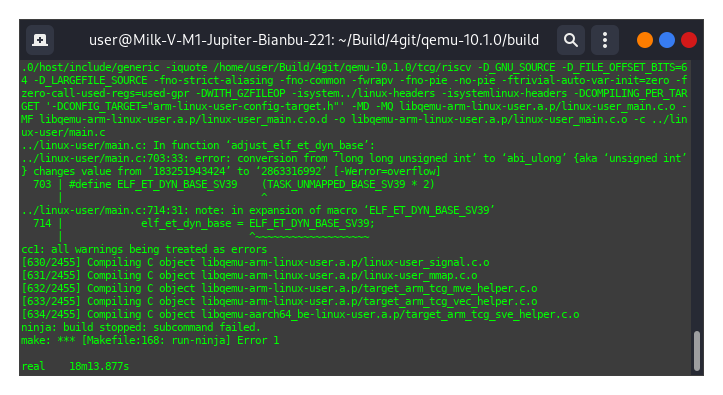

Maybe you can try the follow steps to build qemu from source code in spacemit-k1 board.
mkdir build-qemu-x86
../configure --target-list=x86_64-linux-user --static --disable-system
make
