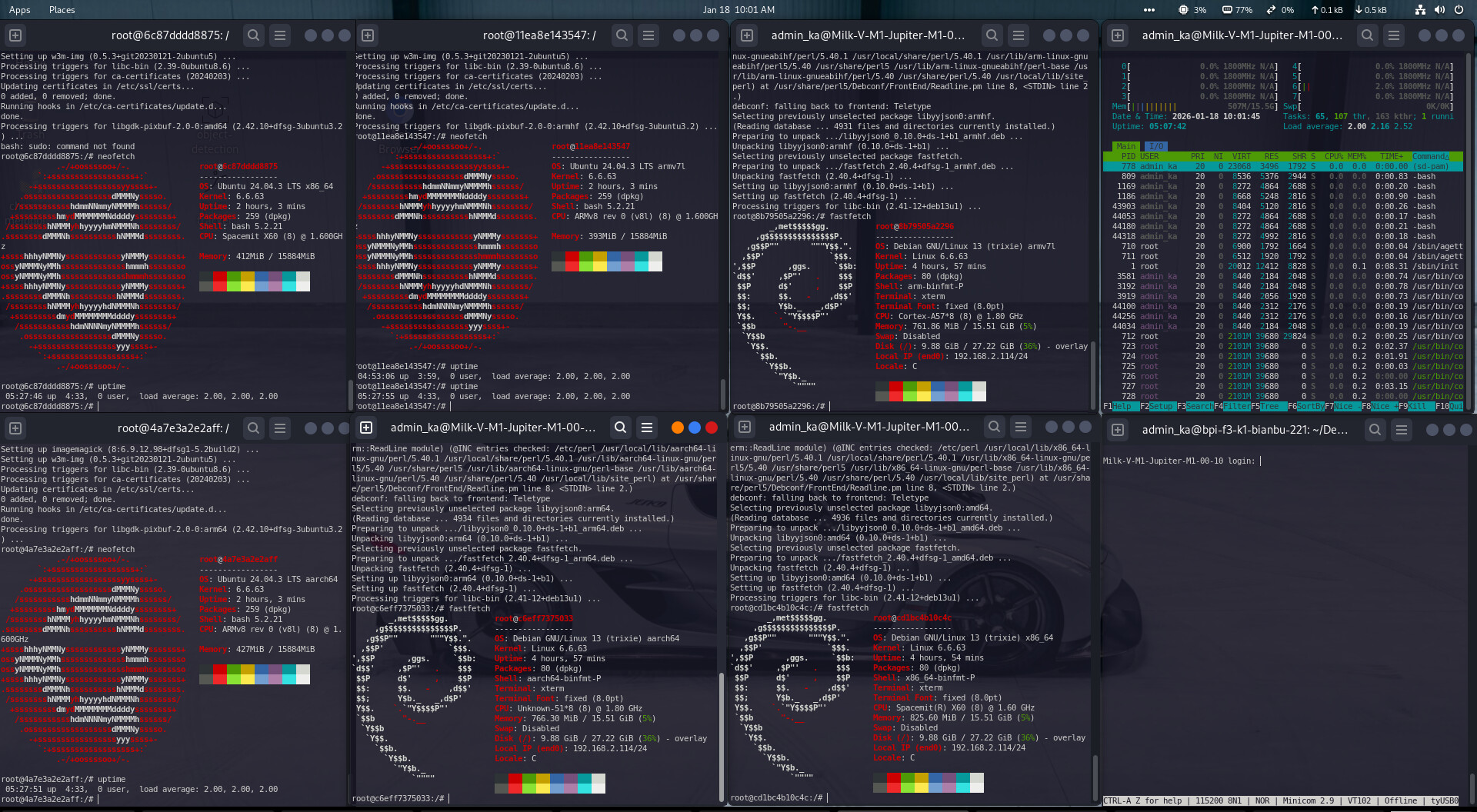

Ubuntu 24.04 containers in podman with the --privileged flag are created, updated, and allow any software to be installed without errors. However, Debian 13.3 containers are created but refuse to be updated. An error occurs. I also checked whether software can be created, updated, and installed in Docker. The Ubuntu version is created, updated, and the software can be installed, too. However, the Debian container is only created, not updated.
The top terminal is Podman, the bottom is Docker.
