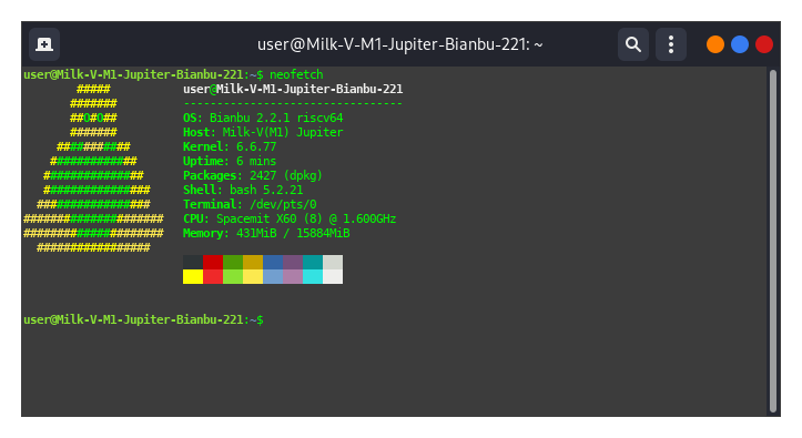

So, after numerous attempts to rebuild the kernel on Milk-V Jupiter, I managed to boot with a kernel patched to version 6.6.77 on Bianbu 2.2.1 .
I used incremental patches .
neofetch
linux-upstream_6.6.77-2_riscv64.changes
linux-upstream_6.6.77-2_riscv64.changes.zip (1.4 KB)

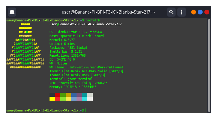

Successfully transferred the *.deb installation files for this kernel from Milk-V Jupiter with Bianbu 2.2.1 to Banana Pi BPI-F3 with Bianbu Star 2.1.7, installed and booted the OS on this kernel.
neofetch
And if kernel 6.6.77 is installed and seems to work without problems, then the next attempt to build the kernel, but this time version 6.6.119, although it passes without errors and even the installation goes almost without problems, I have to make a copy of /usr/lib/linux-image-6.6.63 to /usr/lib/linux-image-6.6.119. But, alas, then it won’t boot.

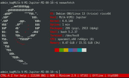

I compiled kernel version 6.6.140 and m1-x_milkv-jupiter.dtb for it, but the board won’t boot.
Even though the kernel successfully loaded:
=> [1645.137] ext4load mmc 0:5 ${kernel_addr_r} Image-6.6.140.gz
12812417 bytes read in 791 ms (15.4 MiB/s)
Then when entering
=> [3250.965] ext4load mmc 0:5 ${fdt_addr_r} spacemit/6.6.140/m1-x_milkv-jupiter.dtb
** Reading file would overwrite reserved memory **
[3273.348] Failed to load ‘spacemit/6.6.140/m1-x_milkv-jupiter.dtb’
So, after some processing, I managed to achieve the following result.

So, having switched to a custom-built Debian, and after numerous attempts, the kernel finally successfully loaded into busybox.
Summary

No FDT memory address configured. Please configure
the FDT address via “fdt addr ” command.
Aborting!
[ 2.588] Uncompressing Kernel Image
[ 2.886] Moving Image from 0x8000000 to 0x200000, end=2350000
[ 2.903] ## Flattened Device Tree blob at 31000000
[ 2.905] Booting using the fdt blob at 0x31000000
[ 2.910] Loading Ramdisk to 7ca2e000, end 7dd815ea … OK
ERROR: reserving fdt memory region failed [ 2.925] (addr=100000 size=200000 flags=4)
ERROR: reserving fdt memory region failed [ 2.933] (addr=300000 size=3000 flags=4)
ERROR: reserving fdt memory region failed [ 2.940] (addr=303000 size=3000 flags=4)
ERROR: reserving fdt memory region failed [ 2.948] (addr=306000 size=f6000 flags=4)
ERROR: reserving fdt memory region failed [ 2.955] (addr=3fc000 size=4000 flags=4)
ERROR: reserving fdt memory region failed [ 2.963] (addr=400000 size=200000 flags=4)
[ 2.968] Loading Device Tree to 000000007ca15000, end 000000007ca2d79f … OK
Starting kernel …

BusyBox v1.37.0 (Debian 1:1.37.0-6+b8) built-in shell (ash)
Enter ‘help’ for a list of built-in commands.
(initramfs) uname -a
Linux (none) 6.6.140 #5 SMP PREEMPT Mon May 25 07:42:48 +04 2026 riscv64 GNU/Linux
(initramfs)
What proposals will there be and will there be any, but for now I don’t see any reaction and no answers - nothing?!
So, a huge thank you to the Spacemit developers and the entire community for their invaluable help building the kernel!!!
