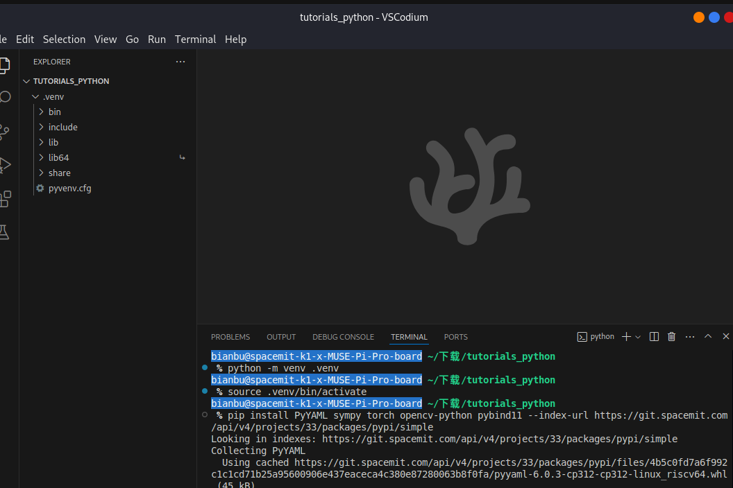

  1. 用vscodium打开文件夹,创建虚拟环境:
python -m venv .venv
source .venv/bin/activate
  1. 环境配置,下载必要的库:
pip install PyYAML sympy torch opencv-python pybind11 --index-url https://git.spacemit.com/api/v4/projects/33/packages/pypi/simple

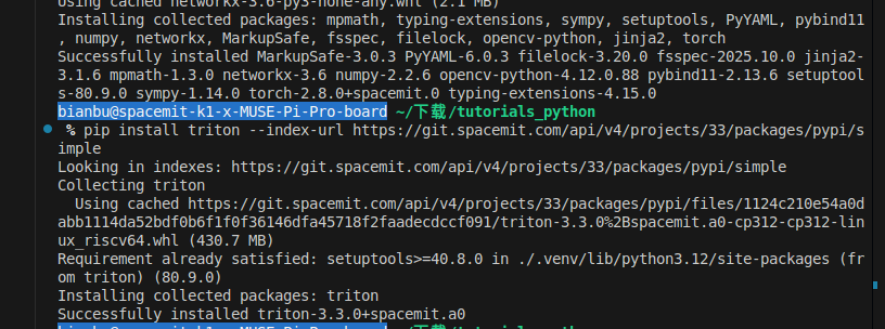

  1. prebuild whl
pip install triton --index-url https://git.spacemit.com/api/v4/projects/33/packages/pypi/simple

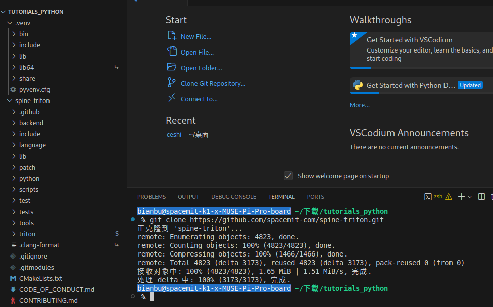

  1. Git clone
git clone https://github.com/spacemit-com/spine-triton.git

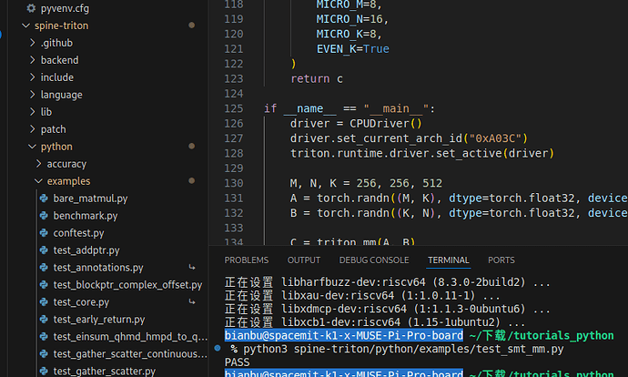

  1. test_smt_mm.py demo
python3 spine-triton/python/examples/test_smt_mm.py
