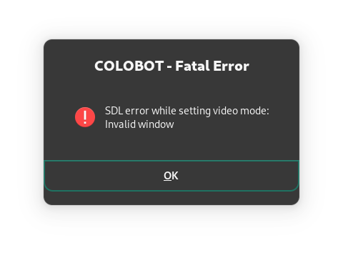

When running Colobot from the command line in a terminal, error windows pop up:
Спойлер
Спойлер
Спойлер

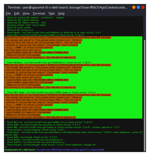

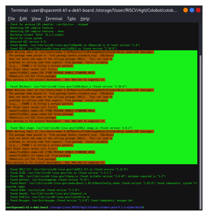

When attempting to build from source code, the following warnings appear (
Спойлер
If I ignore these warnings and let colobot build, then after compiling, when I run it, the same two warning windows pop up again.

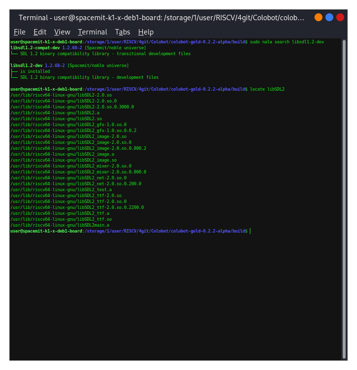

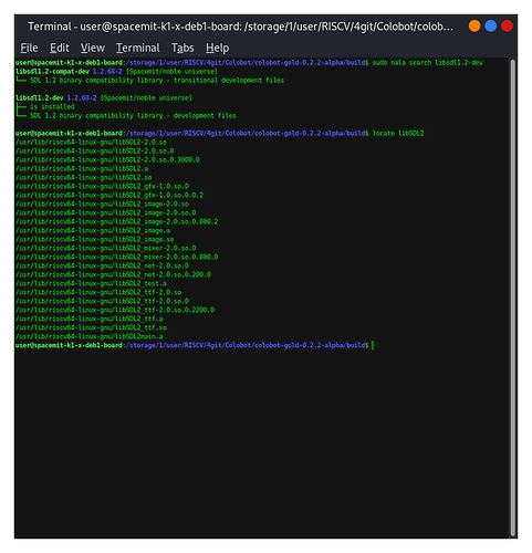

To clarify, the libsdl package is installed, and the library files are currently as follows (
Спойлер
What’s wrong with SDL2 in Bianbu?

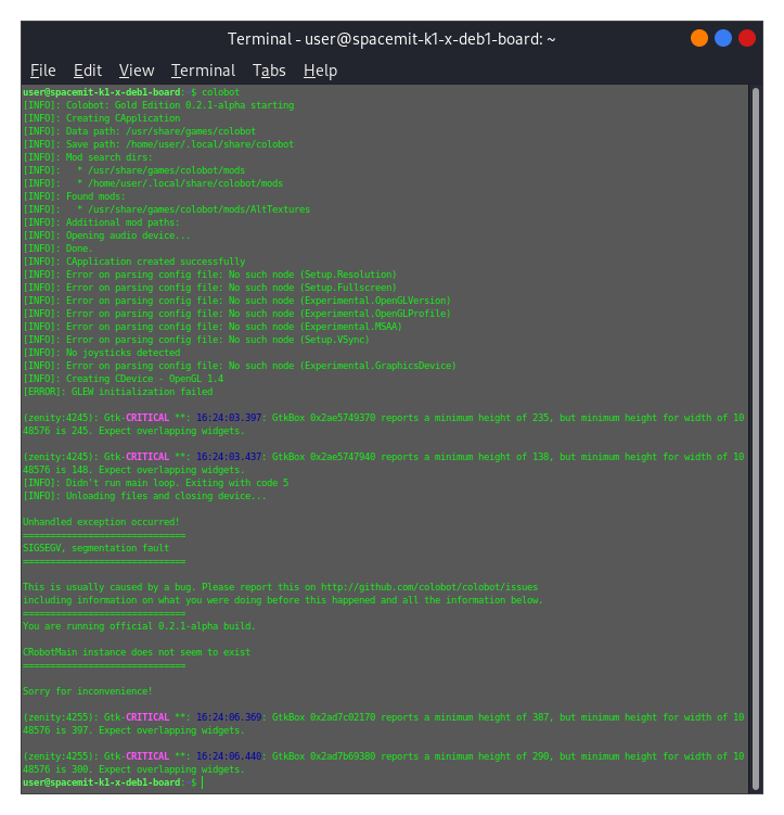

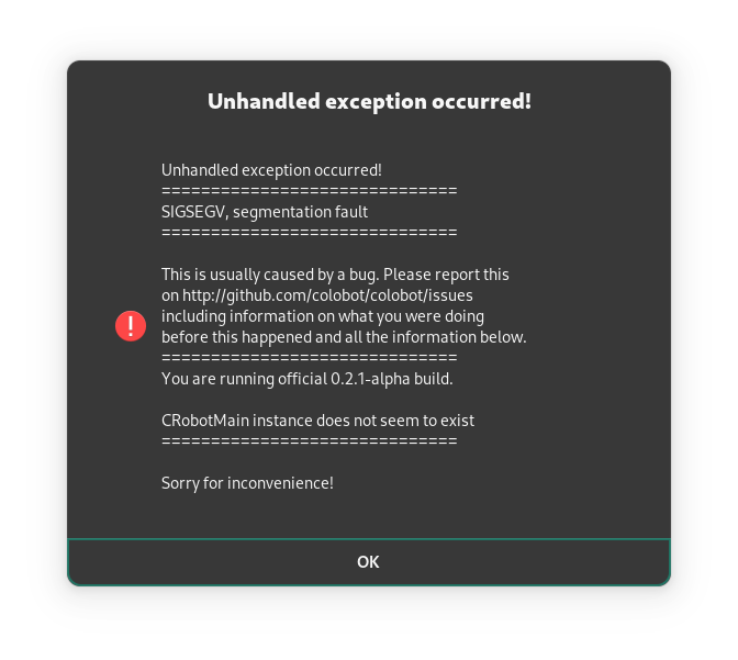

While searching for a solution, I came across a recommendation to run colobot through x11, not wayland - $ SDL_VIDEODRIVER=x11 colobot
And this is the
Spoiler
the game crashes into.

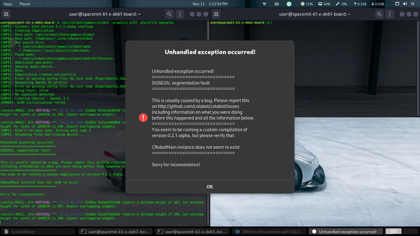

To clarify: I first tried running Colobot Gold Edition 0.2.1-alpha from the Bianbu Star repository. After that version crashed, I tried building Colobot Gold Edition 0.2.2-alpha from source. Judging by the error described in this post, the game crashed because an older version of Mesa was installed on the system. However, that version supports PowerVR B-Series BXE-2-32 MC1 graphics cards, which newer versions of Mesa no longer support. And the game requires a fresh version of Mesa!

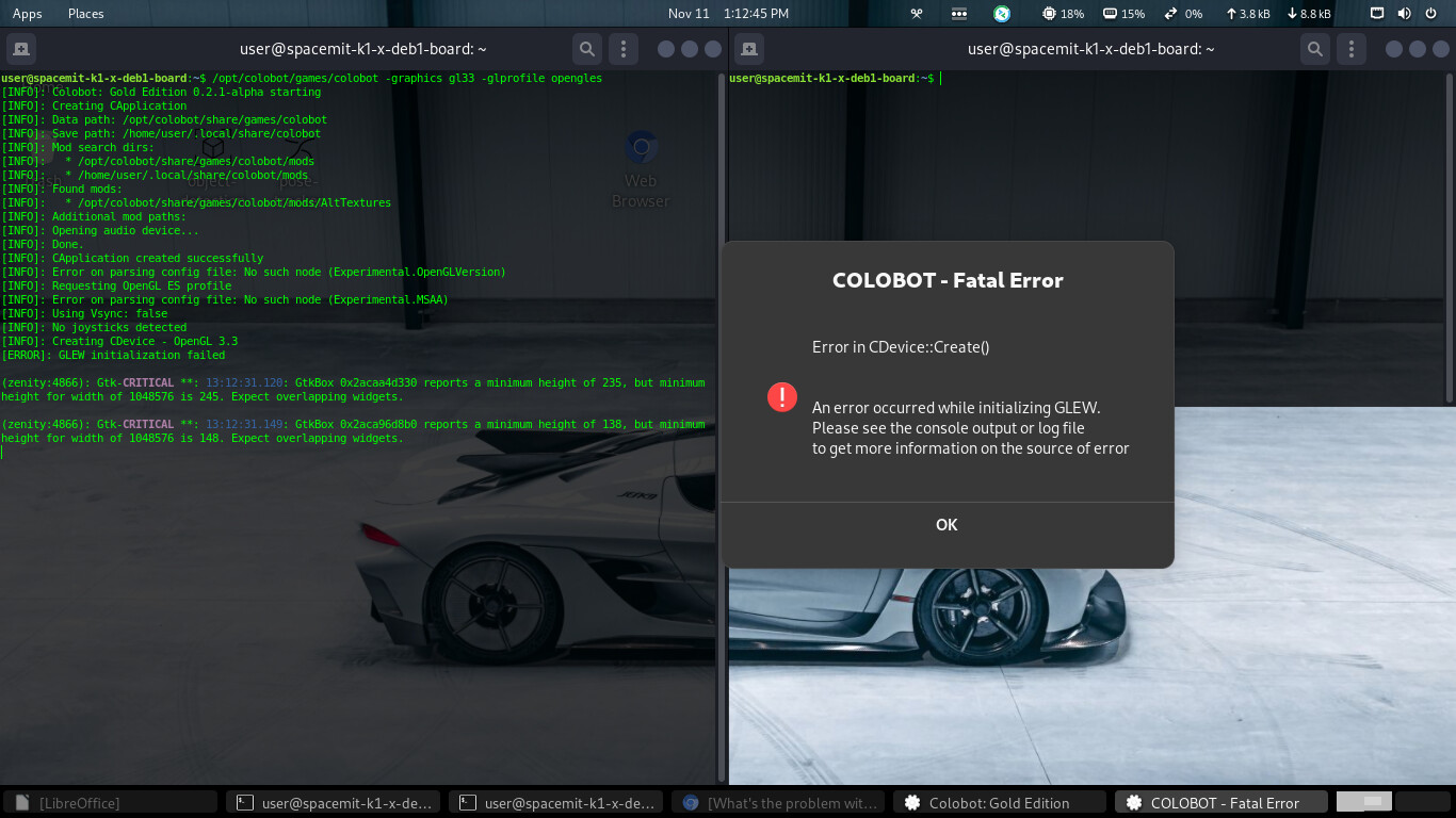

It appears the issue isn’t with the Mesa version, but rather a failure in GLEW initialization. The following command can be used to specify the OpenGL version used at runtime:
colobot -graphics gl33 -glprofile opengles

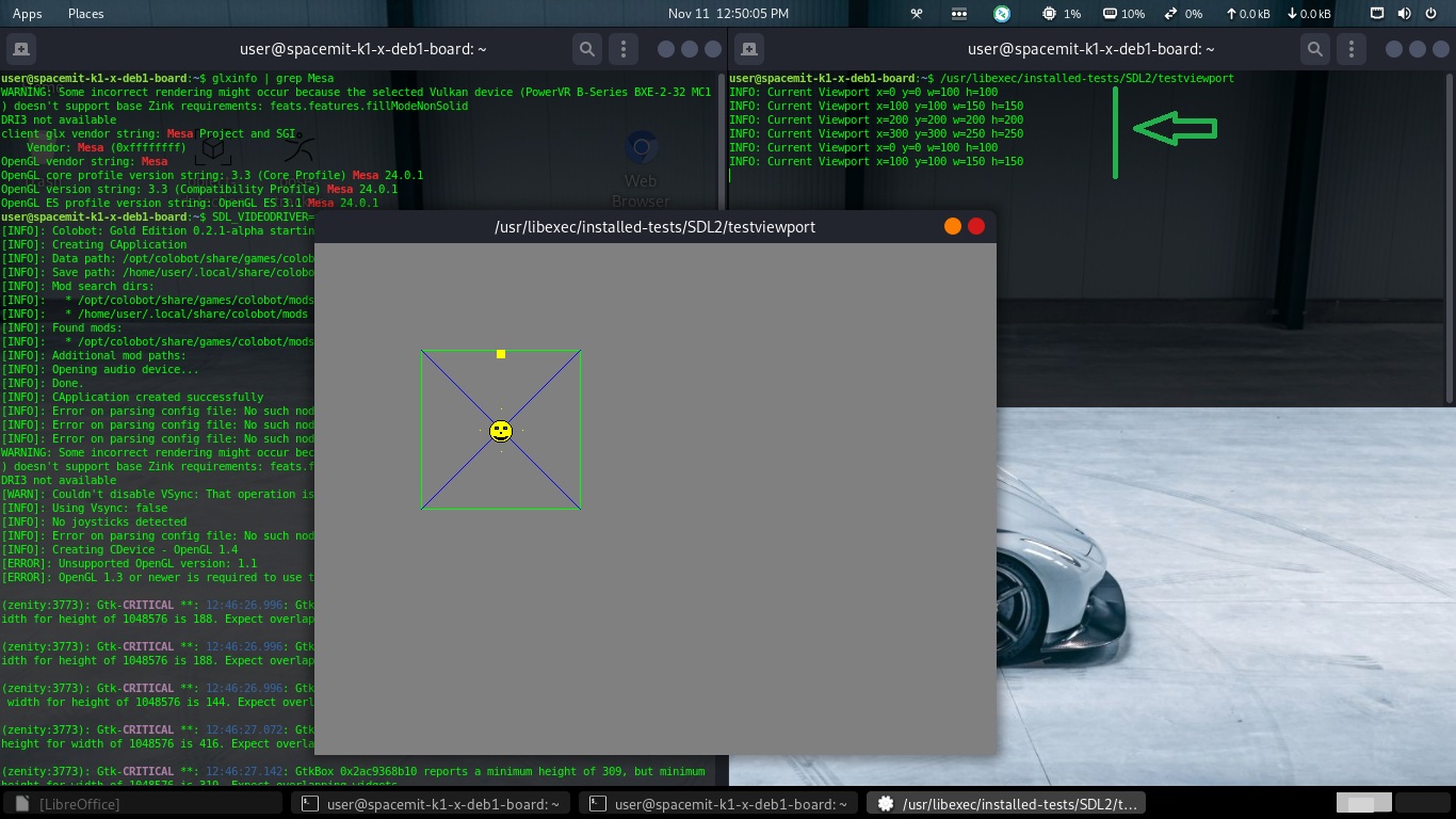

SDL2 should be working correctly, you can run the SDL2 demo to confirm:
sudo apt install libsdl2-tests
cd /usr/libexec/installed-tests/SDL2
./testviewport
Thank you for your interest in this topic!
Spoiler

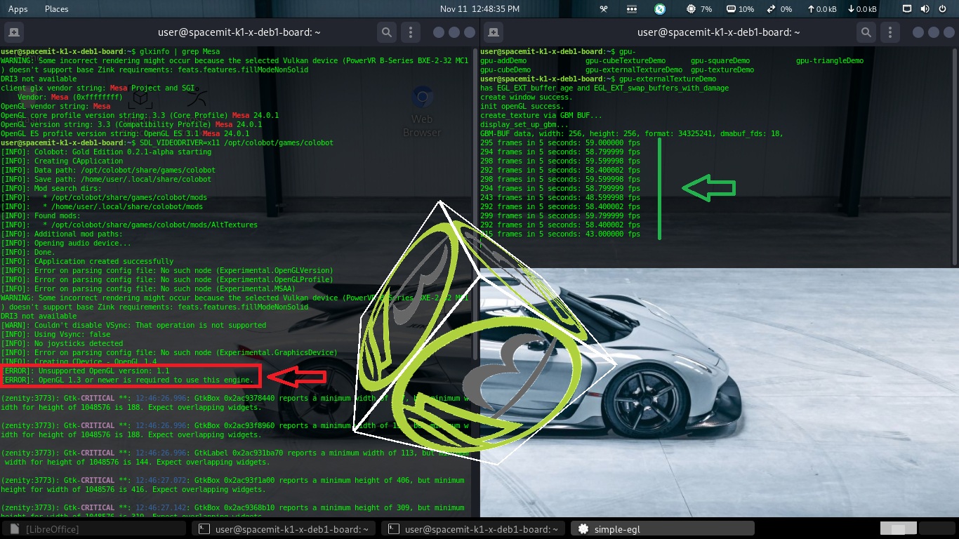

SDL works… at least in this test.
Spoiler
Spoiler

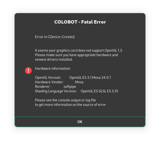

Colobot (in this case, version 0.2.1 was compiled from the source code) still produces errors.
  1. I’ve indicated this with a red arrow here. Colobot 0.2.1 requires OpenGL version 1.4, but the system currently has version 1.1 installed - “It seems your graphics card does not support OpenGL 1.3…” This is the cause of the problem launching Colobot. I tested this with manually compiled versions 0.2.2 and 0.2.1. I can’t test version 0.2.0; for some reason, it doesn’t allow me to download the necessary resources for the build, so I haven’t tested it.

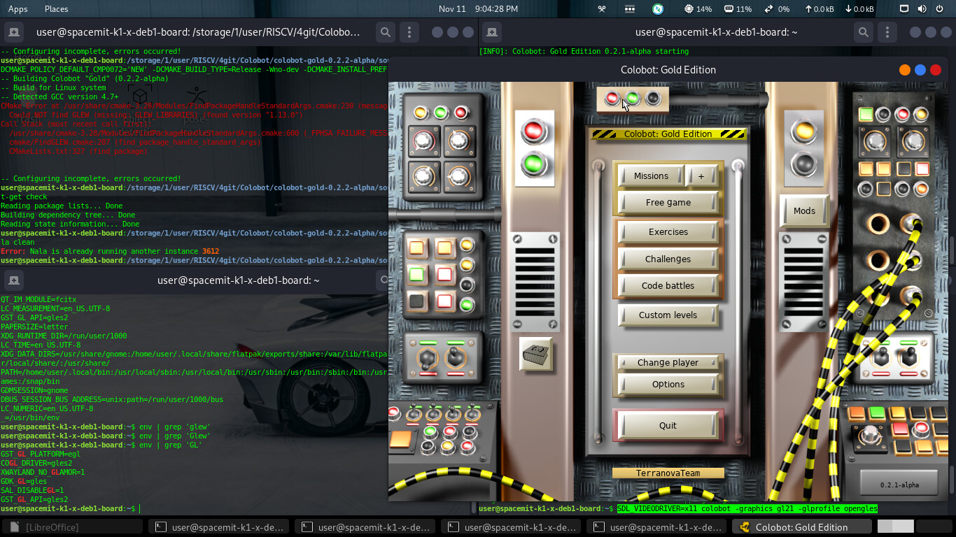

Still, we managed to launch Colobot 0.2.1 installed from the repository.
Spoiler

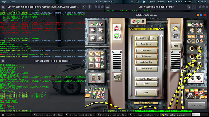

The command to run is as follows:
SDL_VIDEODRIVER=x11 colobot -graphics auto/opengl/gl14/gl21/gl33 -glprofile core/compatibility
It freezes terribly, but it works !
Not use -graphics default & -glprofile default/opengles
Not use wayland SDL_VIDEODRIVER !!!

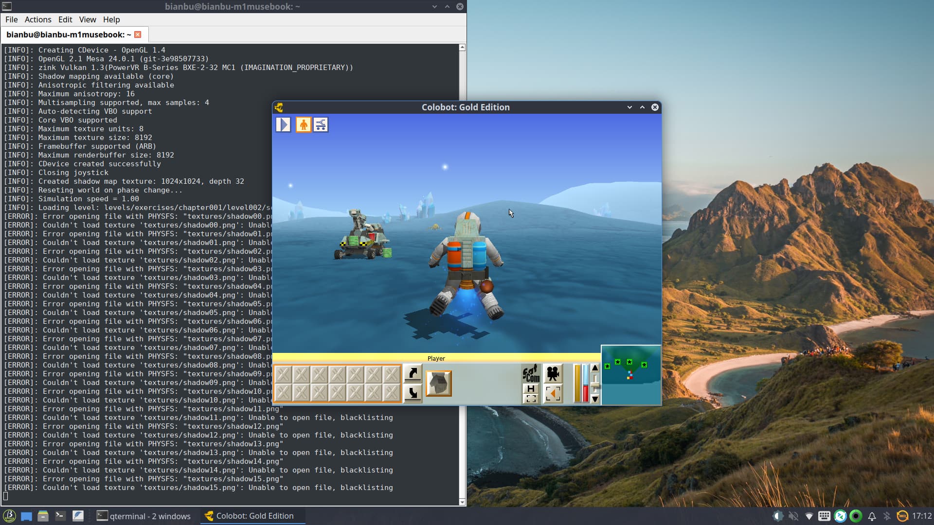

Rebuild glew and run colobot via zink using the following command:
MESA_LOADER_DRIVER_OVERRIDE=zink colobot
A fixed version of glew will be released in a future update.

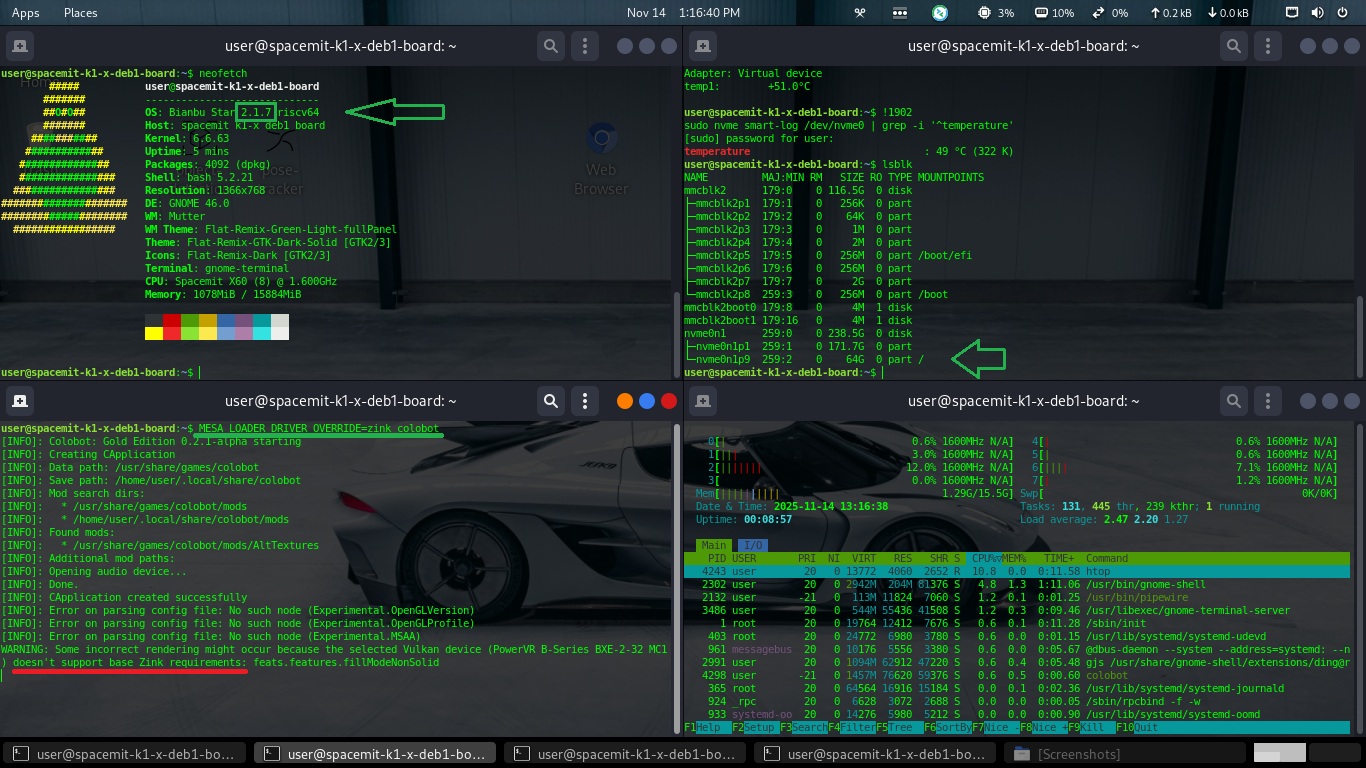

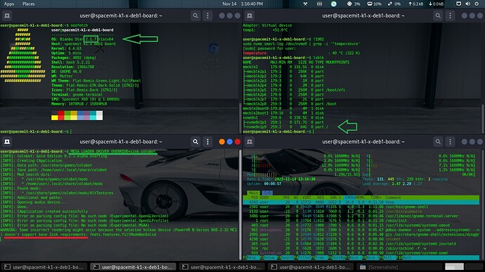

Hi Sterling-Ash !
No, Bianbu Star 2.1.7 is installed, the root partition / is on nvme!
Спойлер
At the moment, there is no possibility to rebuild Glew for Bianbu 3.0, and in Bianbu 2.1.7 version, Colobot does not start with the command “MESA_LOADER_DRIVER_OVERRIDE=zink colobot” .
In any case, thank you for your desire to help!
