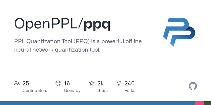

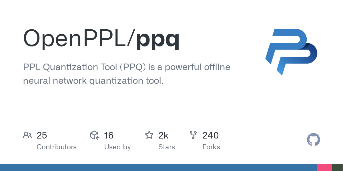

There is xquant which is the quantization tool available from spacemit, however it builds on ppq, is it also possible to simply just use ppq, or will there be some unforeseen problems, or performance issues?
For reference here is the github of the ppq tool:
