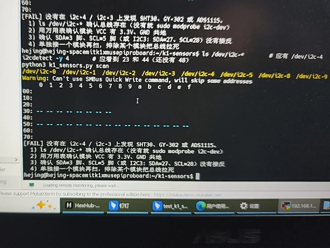

We connected our SHT30 chip (temperature and humidity sensor) to the K1 board using SSH, then I tested whether it could transmit data, but nothing showed up (see the photo above). We connected the wires according to the official pinout, then checked the voltage and current with a multimeter, and both were normal. Why isn’t there any data? Normally, there should be two readings.
We haven’t encountered this issue internally. Please check the wiring, and if it looks correct, capture the waveforms on the I2C lines.

Finally, a stable connection is also important. If you’re using Dupont wires, they may not be very reliable, which can result in poor signal quality.
