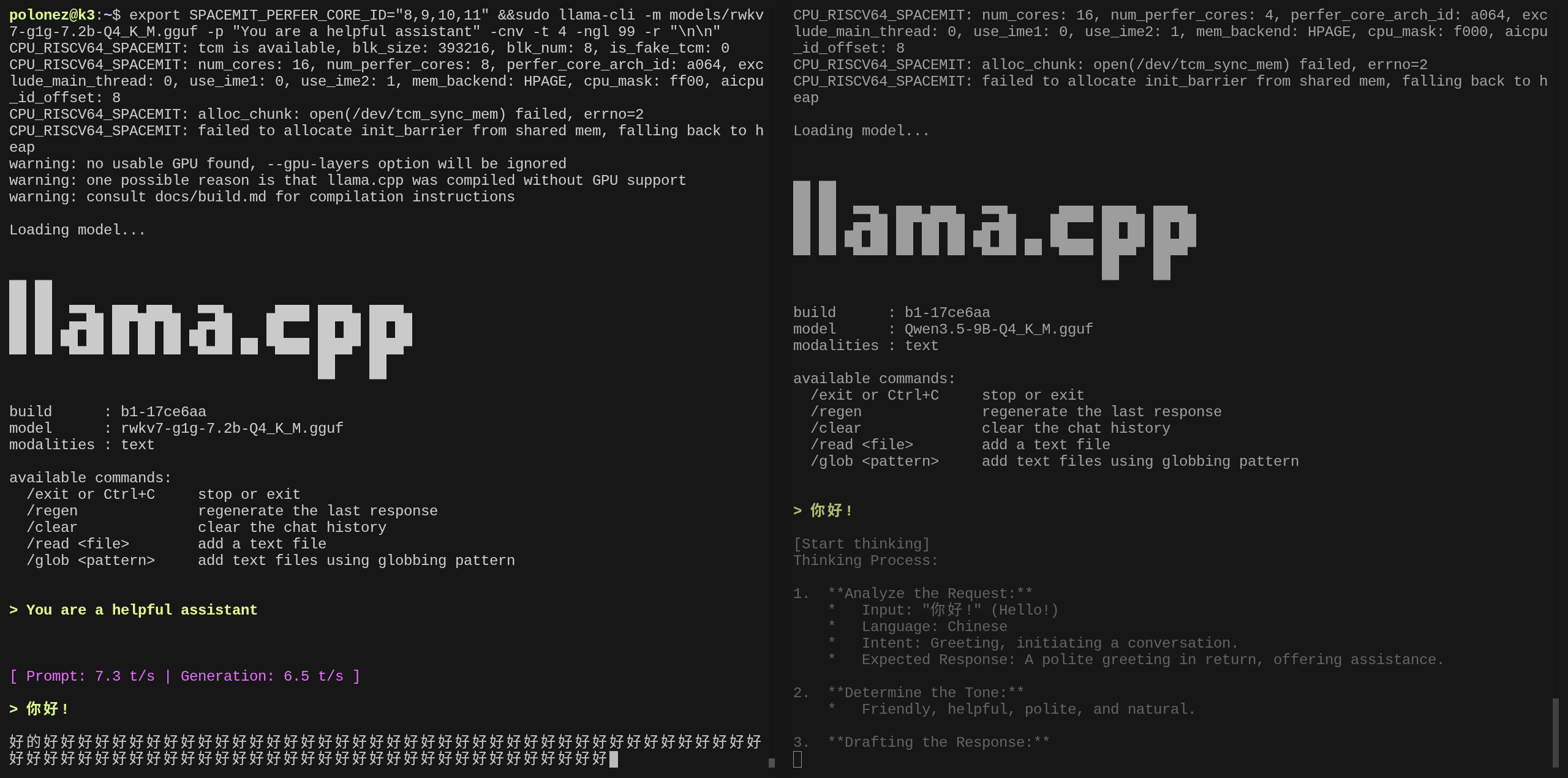

> You are a helpful assistant
[ Prompt: 10.1 t/s | Generation: 6.2 t/s ]
> 为什么声音无法在真空中传播?
好好好好好好好好好好好好好好好好好好好好好好好好好好好好好好好好好好好好好好的的好好的好好好好好好好好的好好好好好好的好好好好好好的好好好好
世好(的好好好的好好的好好的的好好的的好好的的好好的的好好的的好好的的好好的好好好的的好好的的好好的的好好的的好的好的的好好的的好好的的好好的的好好的的好好的好好的好好好的好好的好好的的好好的的好的的好好的的好好的的好好的的好好的的好好的的的好好的的好好的的好好的的
的好,的好,的,
,,(,,的好好,的的
, the
 and and (, (
和
 (  and 好 and a and,好,好,的的好好,的的 University (, Johnson, Johnson Johnson Johnson Johnson Johnson Johnson Johnson Johnson Johnson Johnson Johnson Johnson Johnson Johnson Johnson Johnson Johnson Johnson Johnson Johnson Johnson Johnson Johnson Johnson Johnson Johnson Johnson Johnson Johnson Johnson Johnson Johnson Johnson Johnson Johnson Johnson Johnson Johnson Johnson Johnson Johnson Johnson Johnson Johnson Johnson Johnson Johnson Johnson Johnson Johnson Johnson Johnson Johnson Johnson Johnson Johnson Johnson Johnson Johnson Johnson Johnson Johnson Johnson Johnson Johnson Johnson Johnson Johnson Johnson Johnson Johnson Johnson Johnson Johnson Johnson Johnson Johnson Johnson Johnson Johnson Johnson Johnson Johnson Johnson Johnson Johnson Johnson Johnson Johnson Johnson Johnson Johnson Johnson Johnson Johnson Johnson Johnson Johnson Johnson Johnson Johnson Johnson Johnson Johnson Johnson Johnson Johnson Johnson Johnson Johnson Johnson Johnson Johnson Johnson Johnson Johnson Johnson Johnson Johnson Johnson Johnson Johnson Johnson Johnson Johnson Johnson Johnson Johnson Johnson Johnson Johnson Johnson Johnson Johnson Johnson Johnson Johnson Johnson Johnson Johnson Johnson Johnson Johnson Johnson Johnson Johnson Johnson Johnson Johnson Johnson Johnson Johnson Johnson Johnson Johnson Johnson Johnson Johnson Johnson Johnson Johnson Johnson Johnson Johnson Johnson Johnson Johnson Johnson Johnson Johnson Johnson Johnson Johnson Johnson Johnson Johnson Johnson Johnson Johnson Johnson Johnson Johnson Johnson Johnson Johnson Johnson Johnson Johnson Johnson Johnson Johnson Johnson Johnson Johnson Johnson Johnson Johnson Johnson Johnson Johnson Johnson Johnson Johnson Johnson Johnson Johnson Johnson Johnson Johnson Johnson Johnson Johnson Johnson Johnson Johnson Johnson Johnson Johnson Johnson Johnson Johnson Johnson Johnson Johnson Johnson Johnson Johnson Johnson Johnson Johnson Johnson Johnson Johnson Johnson Johnson Johnson Johnson Johnson Johnson Johnson Johnson Johnson Johnson Johnson Johnson Johnson Johnson Johnson Johnson Johnson Johnson Johnson Johnson Johnson Johnson Johnson Johnson Johnson Johnson Johnson Johnson Johnson Johnson Johnson Johnson Johnson Johnson Johnson Johnson Johnson Johnson Johnson Johnson Johnson Johnson Johnson Johnson Johnson Johnson Johnson Johnson Johnson Johnson Johnson Johnson Johnson Johnson Johnson Johnson Johnson Johnson Johnson Johnson Johnson Johnson Johnson Johnson Johnson Johnson Johnson Johnson Johnson Johnson Johnson Johnson Johnson Johnson Johnson Johnson Johnson Johnson Johnson Johnson Johnson Johnson Johnson Johnson Johnson Johnson Johnson Johnson Johnson Johnson Johnson Johnson Johnson Johnson Johnson Johnson Johnson Johnson Johnson Johnson Johnson Johnson Johnson Johnson Johnson Johnson Johnson Johnson Johnson Johnson Johnson Johnson Johnson Johnson Johnson Johnson Johnson Johnson Johnson Johnson Johnson Johnson Johnson Johnson Johnson Johnson Johnson Johnson Johnson Johnson Johnson Johnson Johnson Johnson Johnson Johnson Johnson Johnson Johnson Johnson Johnson Johnson Johnson Johnson Johnson Johnson Johnson
[ Prompt: 13.4 t/s | Generation: 3.3 t/s ]
Although llama.cpp used eight A100 AI accelerator cores, its output was garbled when using the RWKV7 model.

llama.cpp/ggml中的很多算子都没有按照RISC-V RVV sizeless的规范去写,写死了vlen128、vlen256等等,而且不报错(深恶痛绝),导致A100的vlen1024被错误计算,输出乱码,我们有想法去支持更多ggml算子,敬请期待,当然,如果你有兴趣,也可以自行向llama.cpp提bugfixed PR。至于ollama的问题,ollama现在自己搞了一套计算后端,不再复用ggml,可移植性很差,短期内不会考虑
