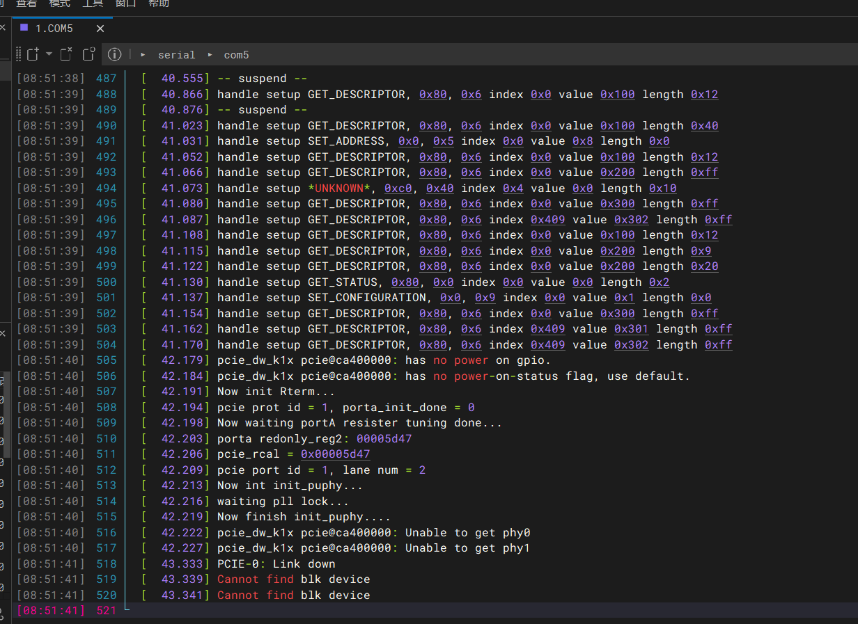

[ 58.799] – suspend –
[ 59.110] handle setup GET_DESCRIPTOR, 0x80, 0x6 index 0x0 value 0x100 length 0x12
[ 59.120] – suspend –
[ 59.270] handle setup GET_DESCRIPTOR, 0x80, 0x6 index 0x0 value 0x100 length 0x40
[ 59.277] handle setup SET_ADDRESS, 0x0, 0x5 index 0x0 value 0x2 length 0x0
[ 59.298] handle setup GET_DESCRIPTOR, 0x80, 0x6 index 0x0 value 0x100 length 0x12
[ 59.313] handle setup GET_DESCRIPTOR, 0x80, 0x6 index 0x0 value 0x200 length 0xff
[ 59.320] handle setup UNKNOWN, 0xc0, 0x40 index 0x4 value 0x0 length 0x10
[ 59.326] handle setup GET_DESCRIPTOR, 0x80, 0x6 index 0x0 value 0x300 length 0xff
[ 59.334] handle setup GET_DESCRIPTOR, 0x80, 0x6 index 0x409 value 0x302 length 0xff
[ 59.353] handle setup GET_DESCRIPTOR, 0x80, 0x6 index 0x0 value 0x100 length 0x12
[ 59.360] handle setup GET_DESCRIPTOR, 0x80, 0x6 index 0x0 value 0x200 length 0x9
[ 59.367] handle setup GET_DESCRIPTOR, 0x80, 0x6 index 0x0 value 0x200 length 0x20
[ 59.375] handle setup GET_STATUS, 0x80, 0x0 index 0x0 value 0x0 length 0x2
[ 59.382] handle setup SET_CONFIGURATION, 0x0, 0x9 index 0x0 value 0x1 length 0x0
[ 59.400] handle setup GET_DESCRIPTOR, 0x80, 0x6 index 0x0 value 0x300 length 0xff
[ 59.408] handle setup GET_DESCRIPTOR, 0x80, 0x6 index 0x409 value 0x301 length 0xff
[ 59.415] handle setup GET_DESCRIPTOR, 0x80, 0x6 index 0x409 value 0x302 length 0xff
[ 59.423] handle setup GET_DESCRIPTOR, 0x80, 0x6 index 0x0 value 0x300 length 0xff
[ 59.433] handle setup GET_DESCRIPTOR, 0x80, 0x6 index 0x409 value 0x301 length 0xff
[ 59.440] handle setup GET_DESCRIPTOR, 0x80, 0x6 index 0x409 value 0x302 length 0xff
[ 60.463] pcie_dw_k1x pcie@ca400000: has no power on gpio.
[ 60.467] pcie_dw_k1x pcie@ca400000: has no power-on-status flag, use default.
[ 60.475] Now init Rterm…
[ 60.477] pcie prot id = 1, porta_init_done = 0
[ 60.481] Now waiting portA resister tuning done…
[ 60.486] porta redonly_reg2: 00005d47
[ 60.489] pcie_rcal = 0x00005d47
[ 60.492] pcie port id = 1, lane num = 2
[ 60.496] Now int init_puphy…
[ 60.499] waiting pll lock…
[ 60.502] Now finish init_puphy…
[ 60.505] pcie_dw_k1x pcie@ca400000: Unable to get phy0
[ 60.510] pcie_dw_k1x pcie@ca400000: Unable to get phy1

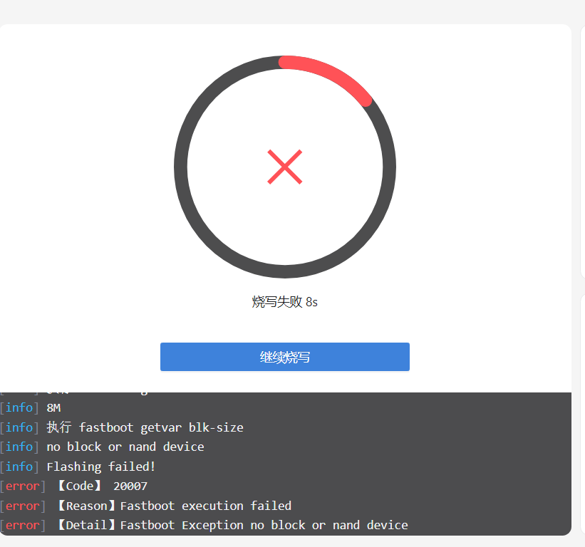

[ 61.616] PCIE-0: Link down
[ 61.622] Cannot find blk device
[ 61.624] Cannot find blk device
