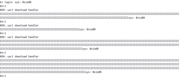

Device still not detected after holding FDL while powering on
It can boot from the SD card and from eMMC.
After removing the SD card, I held down FDL while powering it on, but fastboot couldn’t detect it. When I connected to the serial port, I saw a bunch of CCCCCs and a
sys: 0x1a00
The official titanflasher can’t detect it either.
  1. 烧录口是否有连接数据线到电脑
  2. 更换一根烧录线是否有用
