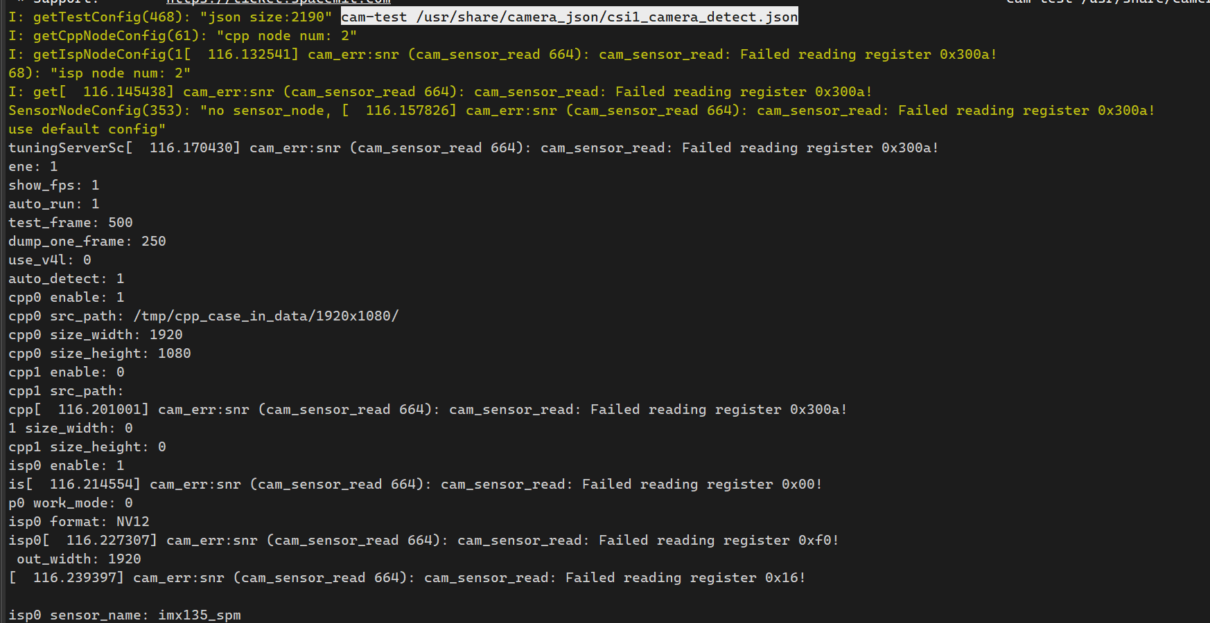

Anyone know why there’s no image after connecting the imx219? Is it not supported on the k1, or is something else wrong? [emoji]

屏幕截图 2026-06-04 231126
1746×900 42 KB

你好,如果是15pin的imx219要跑csi3的json,你现在跑的csi1的是22pin的
