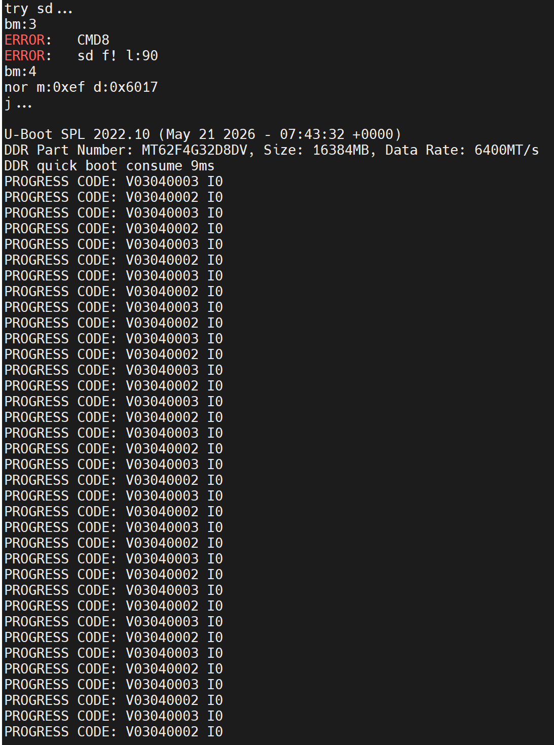

The output is shown above. There were no other issues during flashing, but when I restart the device, I can’t get to the interface, even by pressing F2. Does anyone have any suggestions?

k3-pico-itx开发板,不是com,开机无法进系统,显示屏不亮,但是烧录回u-boot可以正常进界面,链接方式是官方文档里建议的拓展坞,dp转hdmi
请问pico ITX k3刷写UEFI镜像问题有更新吗,目前刷写Ubuntu26.04也是一样得问题,默认启动loader是Uboot,刷写完后引导仍然是Uboot,不是EDKII的UEFI,这个是否有镜像刷写前,需要更新SPI 固件的前置条件
