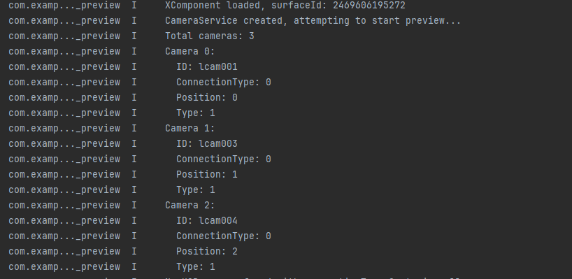

接入USB摄像头后ls video多输出的是video1和video2。

private preferUsbBackCamera(): camera.CameraDevice | undefined {
const manager = this.getManager();
if (!manager) return undefined;
const list: camera.CameraDevice[] = manager.getSupportedCameras();
// 详细日志:打印所有相机设备信息
console.info(`Total cameras: ${list?.length || 0}`);
list?.forEach((cam, index) => {
console.info(`Camera ${index}:`);
console.info(` ID: ${cam?.cameraId}`);
console.info(` ConnectionType: ${cam?.connectionType}`);
console.info(` Position: ${cam?.cameraPosition}`);
console.info(` Type: ${cam?.cameraType}`);
if (!list || list.length === 0) {
console.error('No cameras available');
return undefined;
// 放宽选择条件,尝试所有可能的 USB 摄像头
let target = list.find((d: camera.CameraDevice) =>
d?.connectionType === 2 && d?.cameraPosition !== camera.CameraPosition.CAMERA_POSITION_FRONT
if (!target) {
console.info('No USB camera found with connectionType=2, trying all cameras...');
// 尝试所有非前置相机
if (!target) {
console.info('No non-front camera found, using first available camera');
target = list[0];
console.info(`Selected camera: ${target?.cameraId}, connectionType: ${target?.connectionType}`);
return target;
有没有大佬能帮忙看一下?
